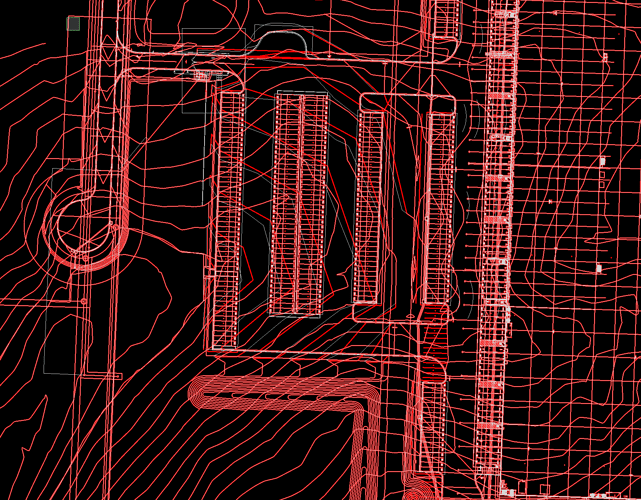

While there is no automated way to do this in TBC, you can follow these steps to provide a quicker way to identify the differences between two CAD files in TBC.
In this image - Lines in Rev 1 Data Only are Red
In this image - Lines that are Rev 2 Data only are White
In this image - all lines that are the same in REV 1 and 2 look Pink / Off Red
You can now more easily see what has changed, what has been added and what has been removed.

Now when you Turn on selected layers from the REV 1 Data Group and the equivalent REV 2 Data layers, you should see the following
Data that is in REV 1 but not in REV 2 will be Red and easily visible
Data that is in REV 2 but not in REV 1 will be White and Easily Visible
Data that is common in Both REV 1 and REV 2 files will look Pink (it is actually a narrow white line on top of a bold Red line but graphically it looks Pink).
You can now review Layer by Layer or groups of layers to identify things that have been Added, Removed or Changed
