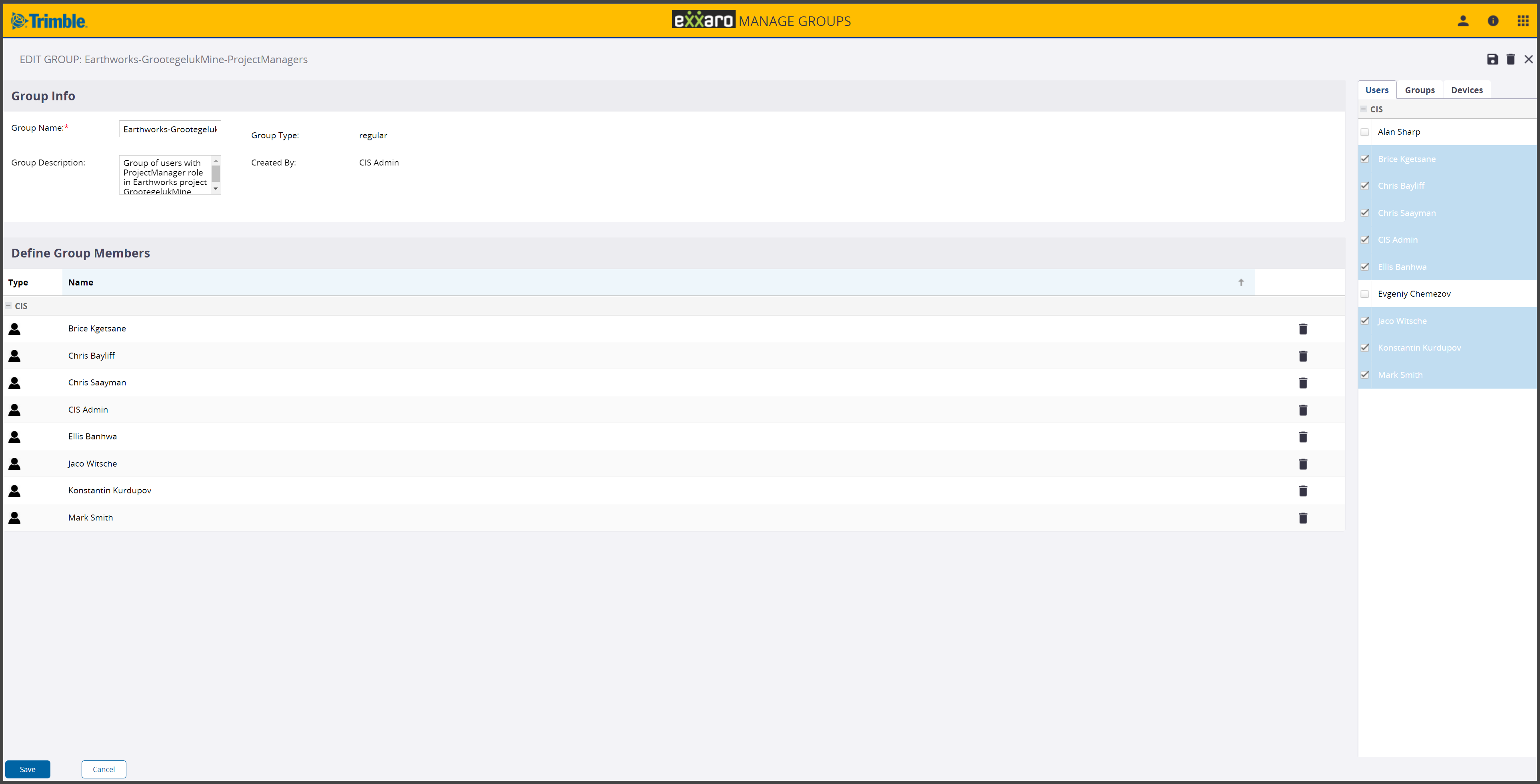

These groups can be managed in the Earthworks application from the image menu button and selecting the option Assign project roles and permissions. From that menu item there is a series of sub menu items as follows
  • Admin (Can do anything)
  • Project Manager (Can do anything in RPS Earthworks or TBC)
  • Engineer (Manages TBC content from inside the TBC application)
  • Work Supervisor (Manages Work Orders on the RPS Earthworks Applications)
  • Project Viewer (View All - Change Nothing)
All of these options operate the same way. select the Group that you wish to edit or change and click the option on the menu
To add a User, Group or Device to the Group selected, select the appropriate Tab on the right side of the screen, find the users, devices or groups that you want to assign the group membership to and click the check box beside the entries. This will add the user to the list in the Define Group Members pane.
To remove a member, device or group from the Group, select the entry in the Define Group Members pane and click the delete icon associated with the entry.
Do not change these Group Names as they are hard coded in the RPS Earthworks System to have a specific use and purpose. Do not delete these Groups unless you fully understand the consequences of doing so.
You can change the description for the group as you see fit for your purposes.
After making changes, press the save button in the Top Right or Lower Left of the screen to save your changes.

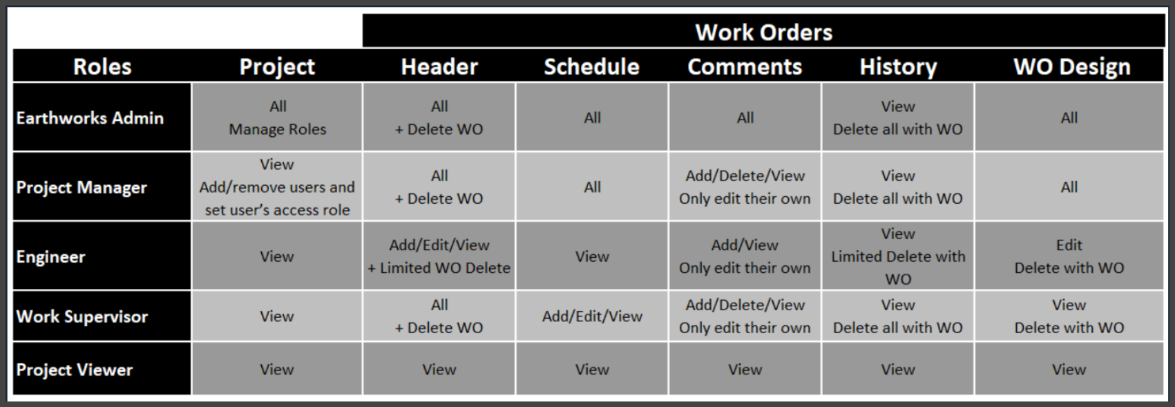

RPS Earthworks Project and Work Order Level Access
The following lists the available processes by Group Type.
