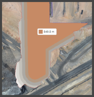

Once a surface elevation map has been loaded, if you hover over the map you will see a pop up indicator that shows the elevation range band for the colored pixel over which your cursor is positioned in the map. Note that the value displayed is not the absolute elevation of the location, simply the elevation band of the legend in which it falls.

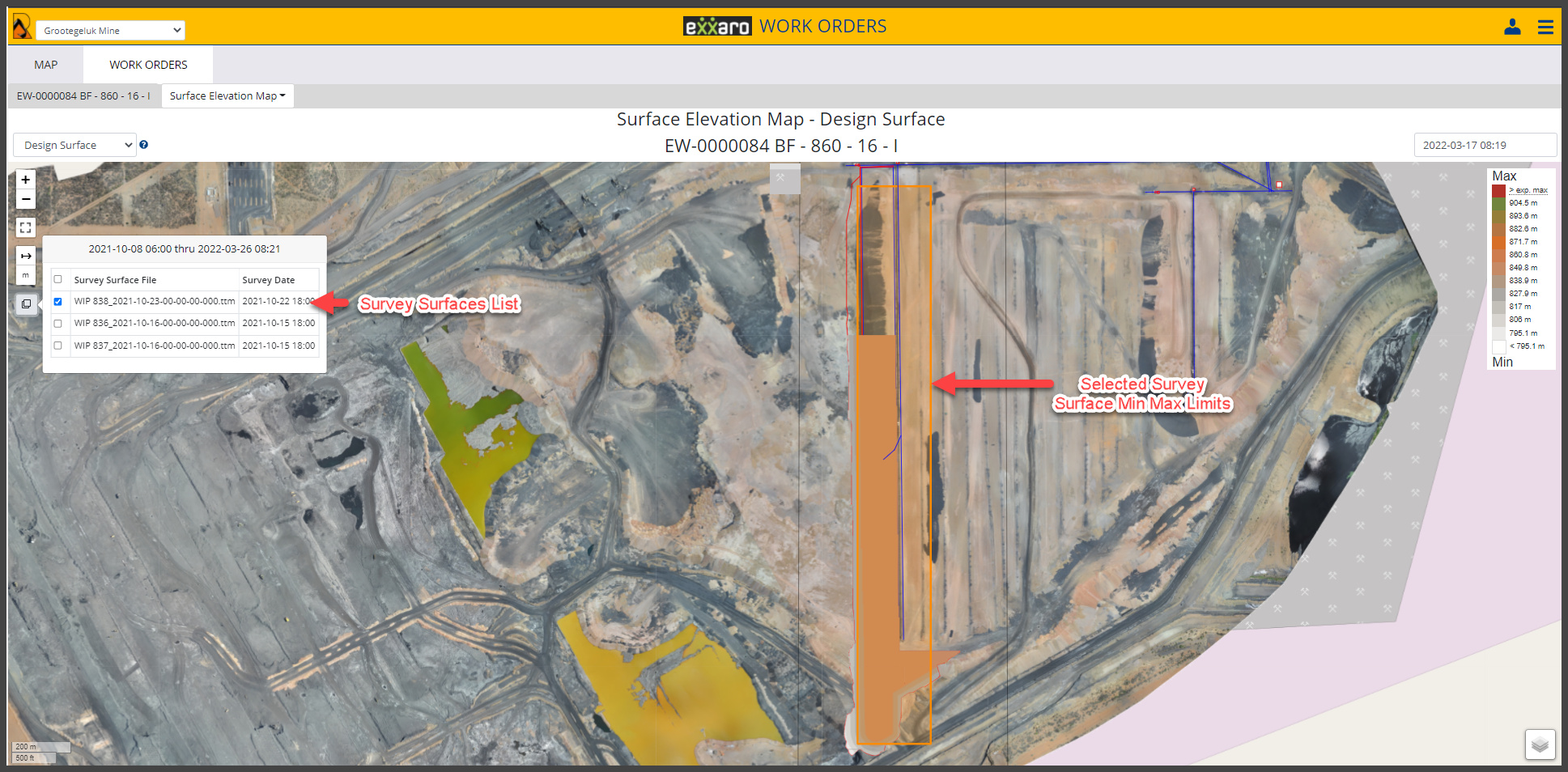

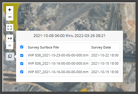

Survey Surface Review
The survey surface review can be accessed from the tools in the top right of the map screen. This review will display the list of surveyed surfaces that have been loaded to RPS Earthworks that have a min max boundary that overlaps or partially overlaps the currently selected work orders min max range.
By selecting the checkboxes next to the survey surfaces list displayed, the map will display the Min Max limits of the selected surveyed surface(s) as shown below
This capability was added to assist you in understanding which survey surfaces have been loaded that affect the currently selected work orders results.
