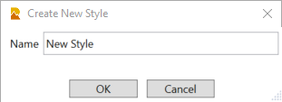

To create a new style click the image button and then enter the style name in the following dialog

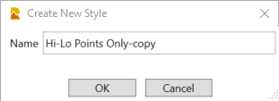

To copy an existing style to start the definition of a new style click the image button and then enter a name for the new style in the following dialog

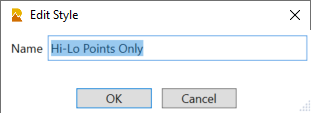

To Edit the name of an existing style, click the image and edit the name of the style in the following dialog
