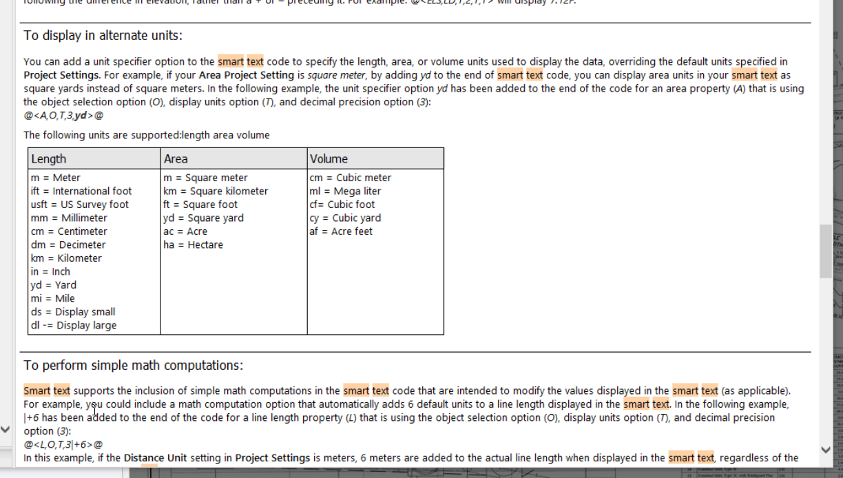

You could potential use smart text as a work around in some cases. I use this to check architectural drawings.
@Plheureux I will try to give that a shot. I looked in the current help and fi is no longer listed. You said they corrected that recently for fi to work as an alternate unit? You would think that if it was in the code to use the alternate unit within smartext it is maybe just an oversight to be able to utilize it at the project settings level? The “Measure Distance” is such a great way for quick checks while working without having to go into dimension. @alan.sharp do you think that is an oversight, or just something they don’t have worked out on the project settings level? Thanks!

Totally understand. Thanks for your thoughtful reply. I just though it was worth a mention in case it was an easy adjustment / refinement at some point. I will have to look to see if there is a possibility to accomplish this with smart text and dimensions.
