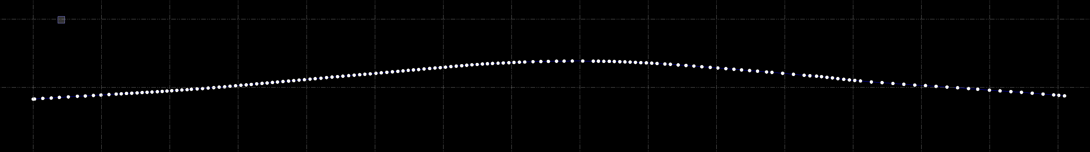

Your observation is correct - I would use Linestring Optimizer instead of the Best Fit Linestring as the controls there are way better - Best Fit is one of the TMLs that we took on from Trimble and we have not touched it as a command - the optimizer has both Vertical and Horizontal Controls - if you dont want the horizontal adjusted put in extremely tight tolerances like 0.001m but then put in tolerances that you are prepared to accept for the vertical e.g. 2cm and a VC length of up to 300m and it will strip out nodes and fit VCs where needed to give a nice smooth profile
Pre Optimization
Post Optimization
